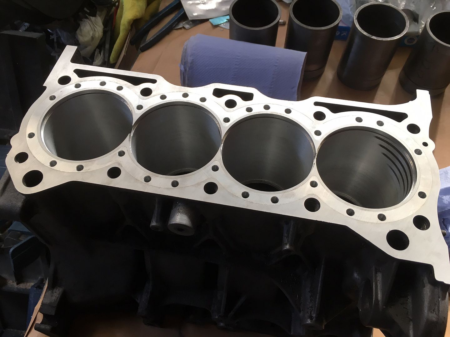

Engine wise, I have been busy building it for a while.
First, I got CNC machine block for “block guard”
Then same data is used to cut billet.
Then cast steel liner to be fitted.
cast in liner bored out.
Oil squirter fitted.
Bottom brace fitted.Image

That looks like a lot of work. What diameter pistons are you going with? It looks like there is not much meat between the cylinders left. I saw a lot of controversy on Redlinegti.com about using the block guard. The closing comments I guess were as long as it is fitted righted. Do you have the dxf file for cutting the bottom brace? That would definitely be something I'm interested in. What is the weigh in for a MK1? I can't place the turbo, but it looks like a t3 inlet flange. Looking awesome thanks for sharing.

bottom brace is from Craig but I think he stopped making them.
My block gurad will be OK as not like veryone else's I used specific not generic.
Also, I have block grouted as well with JB Weld. So it will be solid and no movements means no damaged to the top also.
Not sure how heavy my mk1 will be but I'm hoping it will be 750Kg mark.
My liners are OK for 450Bhp in Rover 1.4 K-series engine with 32psi. I will be going for about 25 to 28psi with Injector dynamics 750cc injectors.
